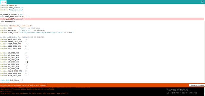

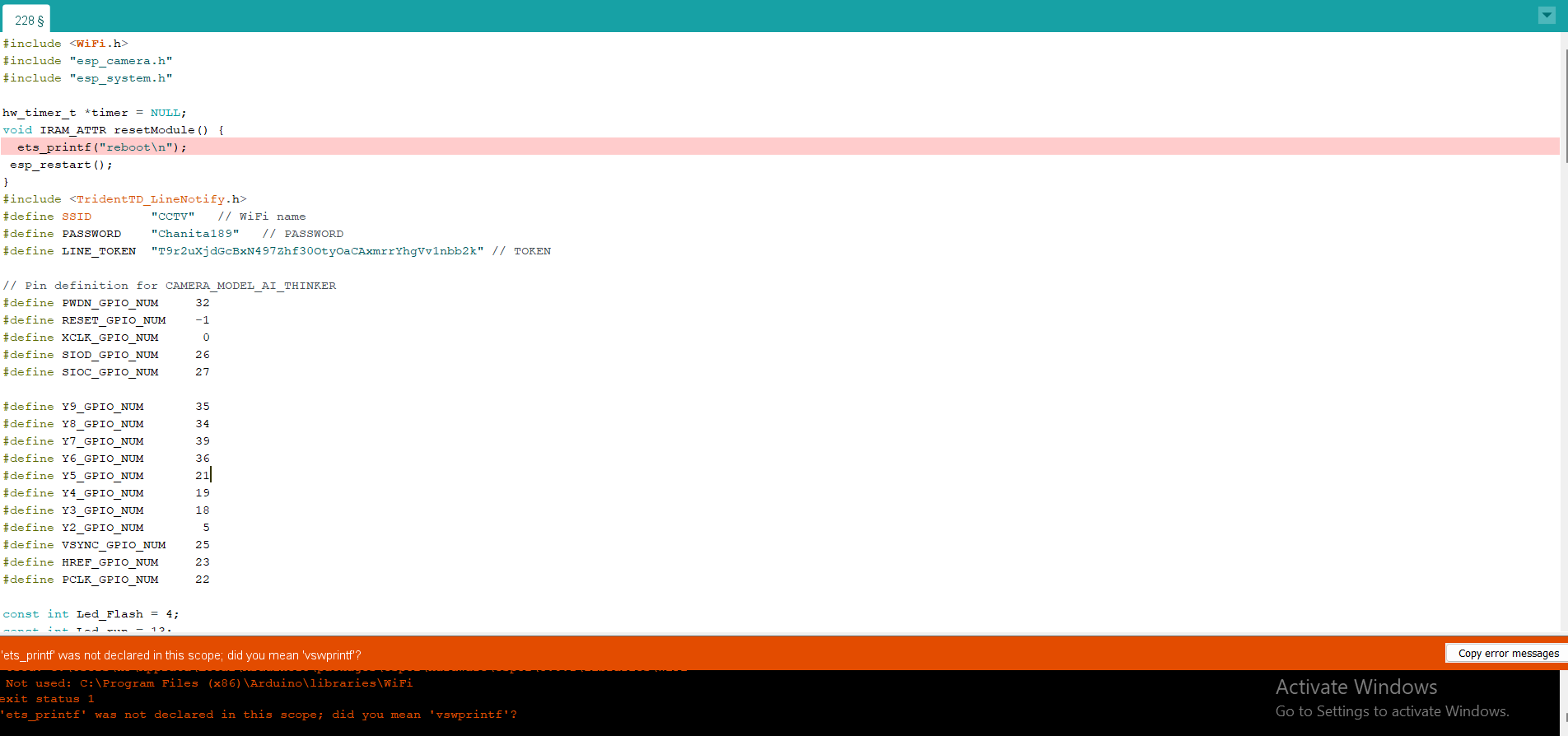

#include <WiFi.h>
#include "esp_camera.h"
#include "esp_system.h"
hw_timer_t *timer = NULL;
void IRAM_ATTR resetModule(){
est_printf("reboot\n");
esp_restart();
#include <TridentTD_LineNotify.h>
#define SSID "CCTV" //WiFi name
#define PASSWORD "Chanita189" //PASSWORD
#define LINE_TOKEN "T9r2uXjdGcBxN497Zhf30OtyOaCAxmrrYhgVv1nbb2k"
// Pin definition for CAMERA_MODEL_AI_THINKER
#define PWDN_GPIO_NUM 32
#define RESET_GPIO_NUM -1
#define XCLK_GPIO_NUM 0
#define SIOD_GPIO_NUM 26
#define SIOC_GPIO_NUM 27
#define Y9_GPIO_NUM 35
#define Y8_GPIO_NUM 34
#define Y7_GPIO_NUM 39
#define Y6_GPIO_NUM 36
#define Y5_GPIO_NUM 21
#define Y4_GPIO_NUM 19
#define Y3_GPIO_NUM 18
#define Y2_GPIO_NUM 5
#define VSYNC_GPIO_NUM 25
#define HREF_GPIO_NUM 23
#define PCLK_GPIO_NUM 22
const int Led_Flash = 4;
const int Led_run = 13;
int PIR_Sensor = 14;
boolean startTimer = false;
unsigned long time_now=0;
int time_capture=0;
void setup() {
Serial.begin(115200);
while (!Serial) { ; }
pinMode(Led_Flash, OUTPUT);
pinMode(Led_run, OUTPUT);
WiFi.begin(SSID, PASSWORD);
Serial.printf("WiFi connecting to %s\n", SSID);
while(WiFi.status() != WL_CONNECTED) { Serial.print("."); delay(400); }
Serial.printf("\nWiFi connected\nIP : ");
Serial.println(WiFi.localIP());
LINE.setToken(LINE_TOKEN);
timer = timerBegin(0, 80, true); //timer 0, div 80Mhz
timerAttachInterrupt(timer, &resetModule, true);
timerAlarmWrite(timer, 20000000, false); //set time in us 15s
timerAlarmEnable(timer); //enable interrupt
camera_config_t config;
config.ledc_channel = LEDC_CHANNEL_0;
config.ledc_timer = LEDC_TIMER_0;
config.pin_d0 = Y2_GPIO_NUM;
config.pin_d1 = Y3_GPIO_NUM;
config.pin_d2 = Y4_GPIO_NUM;
config.pin_d3 = Y5_GPIO_NUM;
config.pin_d4 = Y6_GPIO_NUM;
config.pin_d5 = Y7_GPIO_NUM;
config.pin_d6 = Y8_GPIO_NUM;
config.pin_d7 = Y9_GPIO_NUM;
config.pin_xclk = XCLK_GPIO_NUM;
config.pin_pclk = PCLK_GPIO_NUM;
config.pin_vsync = VSYNC_GPIO_NUM;
config.pin_href = HREF_GPIO_NUM;
config.pin_sscb_sda = SIOD_GPIO_NUM;
config.pin_sscb_scl = SIOC_GPIO_NUM;
config.pin_pwdn = PWDN_GPIO_NUM;
config.pin_reset = RESET_GPIO_NUM;
config.xclk_freq_hz = 20000000;
config.pixel_format = PIXFORMAT_JPEG;
if(psramFound()){
// FRAMESIZE_ +
//QQVGA/160x120//QQVGA2/128x160//QCIF/176x144//HQVGA/240x176
//QVGA/320x240//CIF/400x296//VGA/640x480//SVGA/800x600//XGA/1024x768
//SXGA/1280x1024//UXGA/1600x1200//QXGA/2048*1536
config.frame_size = FRAMESIZE_VGA;
config.jpeg_quality = 10;
config.fb_count = 2;
} else {
config.frame_size = FRAMESIZE_QQVGA;
config.jpeg_quality = 12;
config.fb_count = 1;
// Init Camera
esp_err_t err = esp_camera_init(&config);
if (err != ESP_OK) {
Serial.printf("Camera init failed with error 0x%x", err);
return;
void loop() {
timerWrite(timer, 0); //reset timer (feed watchdog)
long tme = millis();
if(digitalRead(PIR_Sensor) == 1 && startTimer != true){
Camera_capture();
Serial.println("OK");
startTimer = true;
}else if(digitalRead(PIR_Sensor) == 0){
startTimer = false;
time_capture=0;
if(millis() > time_now + 1000) {
time_now = millis();
digitalWrite(Led_run, HIGH);
delay(20);
digitalWrite(Led_run, LOW);
tme = millis() - tme;
if(digitalRead(PIR_Sensor) == 1){
if(++time_capture > 60){
time_capture=0;
Camera_capture();
Serial.println("Over Time");
Serial.println(digitalRead(PIR_Sensor));
delay(200);
void Camera_capture() {
digitalWrite(Led_Flash, HIGH);
delay(100);
digitalWrite(Led_Flash, LOW);
delay(100);
camera_fb_t * fb = NULL;
delay(200);
// Take Picture with Camera
fb = esp_camera_fb_get();
if(!fb) {
Serial.println("Camera capture failed");
return;
Send_line(fb->buf,fb->len);
esp_camera_fb_return(fb);
// Serial.println("Going to sleep now");
// esp_deep_sleep_start();
// Serial.println("This will never be printed");
void Send_line(uint8_t *image_data,size_t image_size){
LINE.notifyPicture("ตรวจพบการเคลื่อนไหว",image_data, image_size);
copy code error มาวางด้วยครับ
