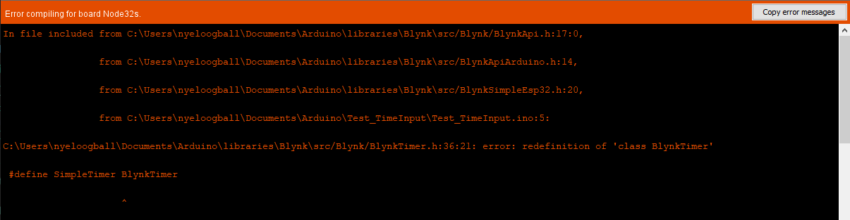

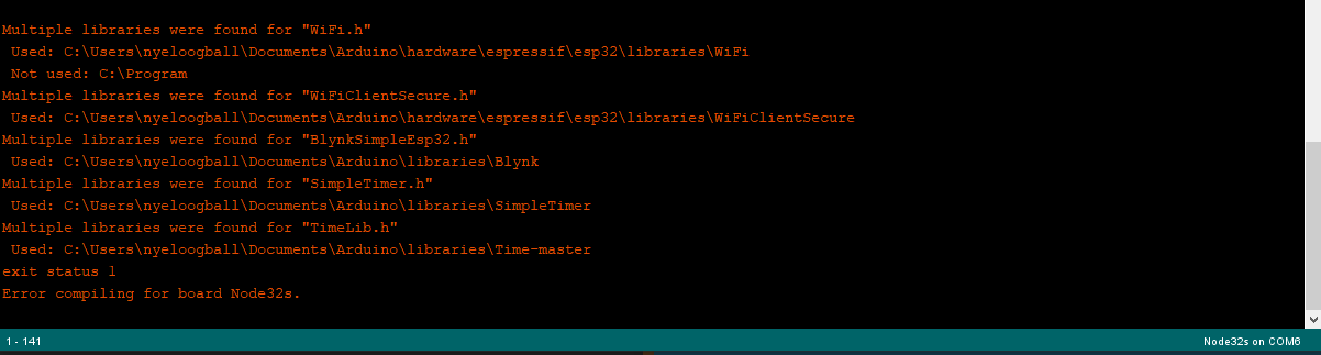

แคปมาให้ดูหน่อยครับในโฟล์เดอร์นี้มีอะไรอยู่บ้าง

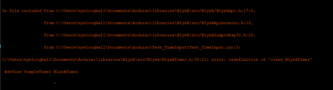

copy ตัว error มาวางเลยครับผมไล่ดูไม่ทั่ว
Arduino: 1.8.10 (Windows 10), Board: "DOIT ESP32 DEVKIT V1, 80MHz, 921600, None"
In file included from C:\Users\nyeloogball\Documents\Arduino\libraries\Blynk\src/Blynk/BlynkApi.h:17:0,
                 from C:\Users\nyeloogball\Documents\Arduino\libraries\Blynk\src/BlynkApiArduino.h:14,
                 from C:\Users\nyeloogball\Documents\Arduino\libraries\Blynk\src/BlynkSimpleEsp32.h:20,
                 from C:\Users\nyeloogball\Documents\Arduino\Test_TimeInput\Test_TimeInput.ino:5:
C:\Users\nyeloogball\Documents\Arduino\libraries\Blynk\src/Blynk/BlynkTimer.h:36:21: error: redefinition of 'class BlynkTimer'
 #define SimpleTimer BlynkTimer
C:\Users\nyeloogball\Documents\Arduino\libraries\SimpleTimer/SimpleTimer.h:10:7: note: in expansion of macro 'SimpleTimer'
 class SimpleTimer {
C:\Users\nyeloogball\Documents\Arduino\libraries\Blynk\src/Blynk/BlynkTimer.h:36:21: error: previous definition of 'class BlynkTimer'
C:\Users\nyeloogball\Documents\Arduino\libraries\Blynk\src/Blynk/BlynkTimer.h:41:7: note: in expansion of macro 'SimpleTimer'
 class SimpleTimer {
Multiple libraries were found for "WiFiClientSecure.h"
 Used: C:\Users\nyeloogball\Documents\Arduino\hardware\espressif\esp32\libraries\WiFiClientSecure
Multiple libraries were found for "BlynkSimpleEsp32.h"
 Used: C:\Users\nyeloogball\Documents\Arduino\libraries\Blynk
Multiple libraries were found for "SimpleTimer.h"
 Used: C:\Users\nyeloogball\Documents\Arduino\libraries\SimpleTimer
Multiple libraries were found for "TimeLib.h"
 Used: C:\Users\nyeloogball\Documents\Arduino\libraries\Time-master
Multiple libraries were found for "WiFi.h"
 Not used: C:\Program
exit status 1
Error compiling for board DOIT ESP32 DEVKIT V1.
This report would have more information with
"Show verbose output during compilation"
option enabled in File -> Preferences.
1.2
โอเคครับ ในไดร์ C ไม่น่ามีอะไรผิด ตอนนี้ศึกษาจากกระทู้นี้ดู น่าจะเคสเดียวกัน
